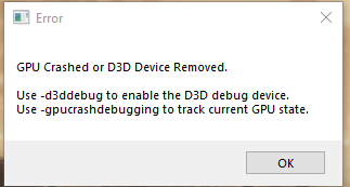

<figure><img src="/files/XfcriF4erjeJB0Pljdye" alt=""><figcaption><p>TDR</p></figcaption></figure>

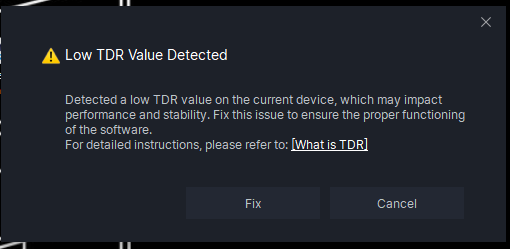

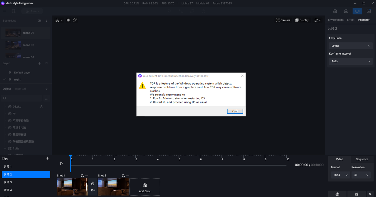

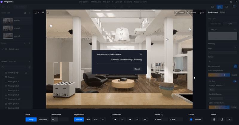

Most users of graphics software may have once seen a notification which warns that the computer's TDR delay value is too low. It is also likely to pop up when you render high-resolution images or videos in D5 Render.
To solve this problem and ensure a good experience in D5 Render, please follow these steps to increase the TDR recovery value:

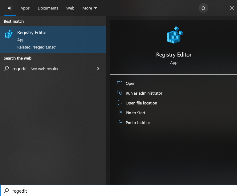

1\. Open the Registry Editor of your Windows system (administrator permission required)

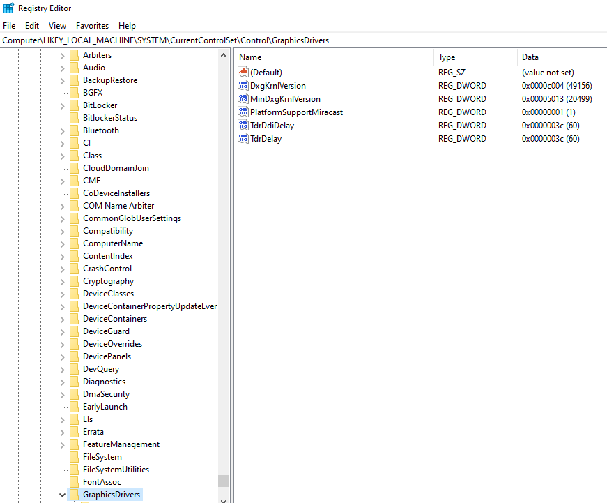

2\. Navigate to this key:
Computer\HKEY\_LOCAL\_MACHINE\SYSTEM\CurrentControlSet\Control\GraphicsDrivers
<figure><img src="https://assets-global.website-files.com/62cc341ca212fe5f03df86e6/6396bf435cf3b1d68c79d8a1_7.png" alt=""><figcaption></figcaption></figure>

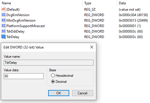

3\. Add or Edit the TdrDelay value
Right click on the TdrDelay key > Modify, then switch **to Decimal** and **enter the Value data as 60.**
<figure><img src="https://assets-global.website-files.com/62cc341ca212fe5f03df86e6/6396bf433a8b1175ab57f3bf_8.png" alt=""><figcaption></figcaption></figure>

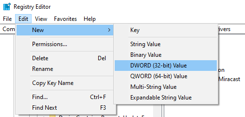

If the **TdrDelay** key doesn't exist, please create a new one through **Edit >New > DWORD (32bit) Value** . Name it "**TdrDelay**".
<figure><img src="https://assets-global.website-files.com/62cc341ca212fe5f03df86e6/6396bf44d716ffb31596a03d_9.png" alt=""><figcaption></figcaption></figure>

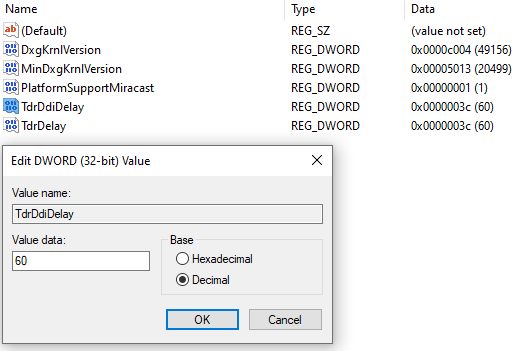

4\. Add or Edit the TdrDdiDelay value
Do the same as Step 3 for the **TdrDdiDelay** value.
