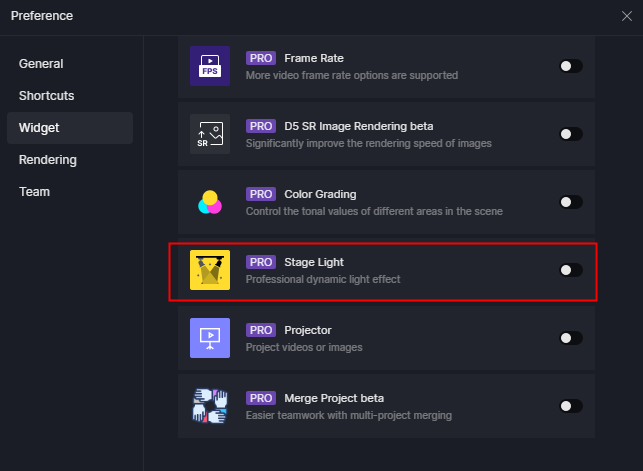

  • Go to Menu > Preference > Widget , and you can check what you have installed, click to toggle on/off and manage your widgets.
