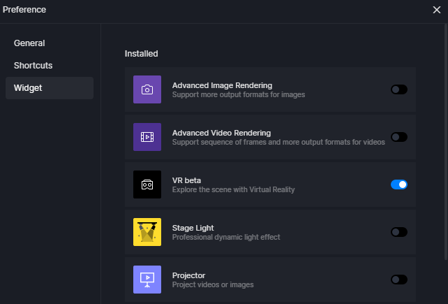

D5 Widget is a customized extension module of D5 Render, aiming to provide advanced features while keeping the simplicity. Go to Menu > Preference > Widget, and you can check what you installed, switch on/off with one click to manage your widgets.

1. Enable the VR beta widget in D5.
Open a D5 scene file, go to Menu > Preference > Widget, find VR beta then turn it on. This feature will take effect after rebooting D5 Render.
