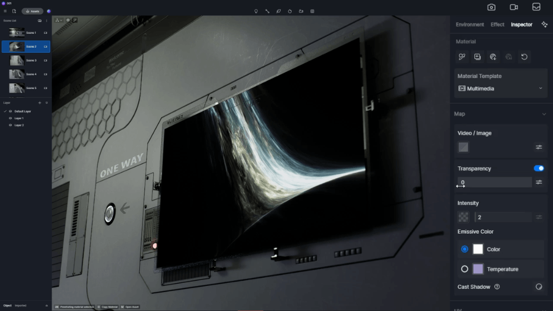

It controls the map transparency. The larger the value, the more transparent it becomes.
1. Multimedia Material has two types of Transparency options available:
* **Global Matte:** Adjust the transparency to change the overall effect of the screen.
* **Luma Matte:** Transparency will be determined by the brightness value of the pixels. The darker the area, the more transparent it is, and a pure black area is complete transparency.
2. Affect Transparent ID&#x20;
* Affect Transparent ID controls whether the transparent video appears in Transparent Channel Map or not, facilitating post-processing.

### Intensity
Controls the emissive brightness of the video.
> Multimedia materials themselves also function as a form of lighting.&#x20;
> In addition to adding video assets to **display devices such as TVs and computers in a scene**, they can also **achieve effects like breathing lights and changing LED lights** through the use of video assets.
### Color
Overlay specified colours on the original emissive video material.
### Temperature
Overlay specified colour temperatures on the original emissive video material.
### Cast Shadow
Controls whether the light emitted by the video material affects the diffuse reflection of surrounding objects.
> Note: Currently supports video files under 200M.
