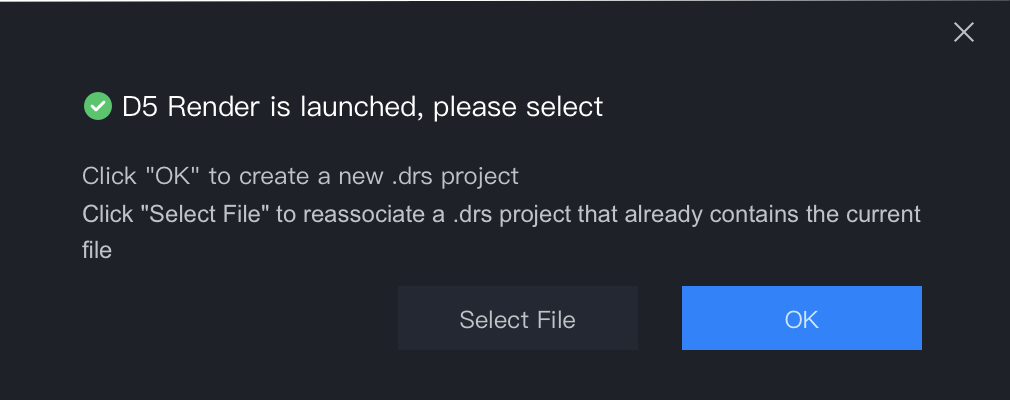

**Create a project:** create an empty. drs scene and import the .rvt file from the current Revit to establish a connection with D5 Render
**Associate a project:** associate the current .rvt file in Revit with the model file in the existing .drs scene
![](/files/-MkbW0FD9La6JyEjt2h1)
When a model file already exists in D5 Render, the first time you synchronize it, you need to connect the synchronized model to an existing model in the resource list or create a new model.
By default, D5 Render is closed. First, you need to click<img src="/files/-MkYRSrPIkTgciLY51cP" alt="" data-size="line">to start D5 Render and choose to create a project or associate a project, to active D5 Converter.
If D5 Render is already started, you need to choose to create a new model or select the imported model linkage in the pop-up window.
