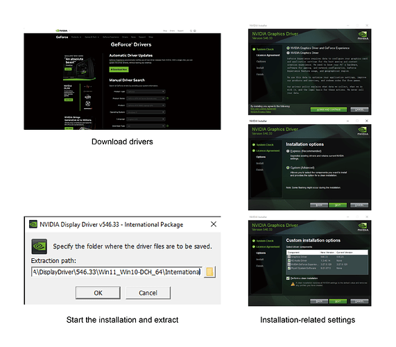

<mark style="background-color:purple;">Manually search for drivers:</mark>
1. According to your specific hardware configuration, please select the appropriate graphics card driver. You can find multiple versions of the graphics card driver on the official NVIDIA website, allowing you to download the corresponding version.
2. Double-click the downloaded driver to install it.
3. Retain the default directory, click ok, and wait until the decompression is complete.
4. Select Install "NVIDIA Graphics Driver ", click “Agree and continue”
5. Select ‘‘Custom’’, click ‘‘Next’’
6. Click ‘‘Perform Clean Installation’’, click Next
7. After the installation is complete, restart the PC
> Note: During the installation process, it is normal that the monitor may uninterruptedly experience several black screens or changes in display size.
